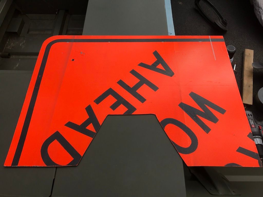

This is a mod I did last fall that I failed to document on here. Luckily I took a few pics during the process and they were saved to my Photobucket.

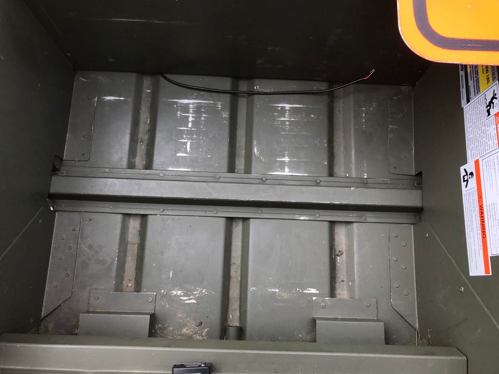

This mod was adding a small floor to the small space in the stern where the gas tank, battery, and a few other things go or will go. As you can see the area has a 1 & 1/2" rib right in the middle. Also (not sure if the picture portrays it) but try to notice that the right side wall is a little crooked which made cutting the floor to fit a little harder.

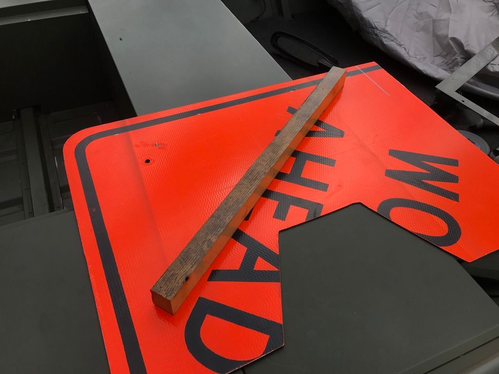

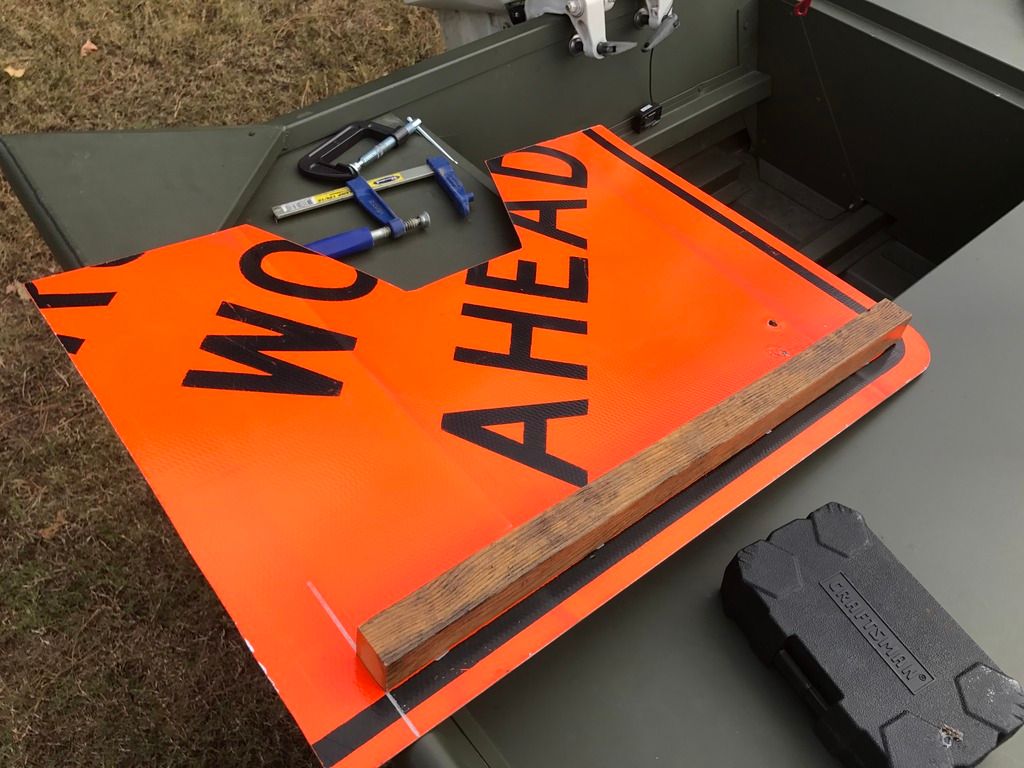

The hardest part of this was simply getting material. For whatever reason, my dad happened to have a road sign in his barn. I believe one of my brother's friends grabbed it and somehow it ended up at my parents' house. Anyways, it was fairly thick aluminum so I just decided to use it since it was free. I cut it to fit using a jigsaw and metal cutting blade and filed the edges by hand. I cut a notch in the rear middle to allow for room to install the plug and to add a bilge and possibly thru-hull livewell pump.
I cut it so the sign face would be down so I could paint the bare aluminum back side. I lightly sanded the aluminum and cleaned it but probably didn't prep it as I should. I used self etching primer first and then painted it with a can of factory touch up paint I got from my dealer for free. I don't have a good picture so just reference one farther down.
The idea was to attach the floor directly to the rib in the middle as well as to the two angled transom braces and add a support for the front edge. For the front support, I ripped a 2x4 stud in half (or whatever dimension aligned with the height of the rib). Then I coated it in many coats of spar urethane. Then I simply attached it to the underside front of the floor with a few sheet metal screws.
Here is what it looked like with some of the fasteners in. The gap in the upper right hand corner reflect the misalignment of the side wall I mentioned. The board I used as a brace in the front is not attached to the boat anywhere. Te flooring is pretty rigid plus the weight of the battery holds it down. So far I have not noticed any vibrations coming from it when underway. The grommet in the top middle is for the power leads for my Humminbird Helix 5 I now have mounted on the rear deck.

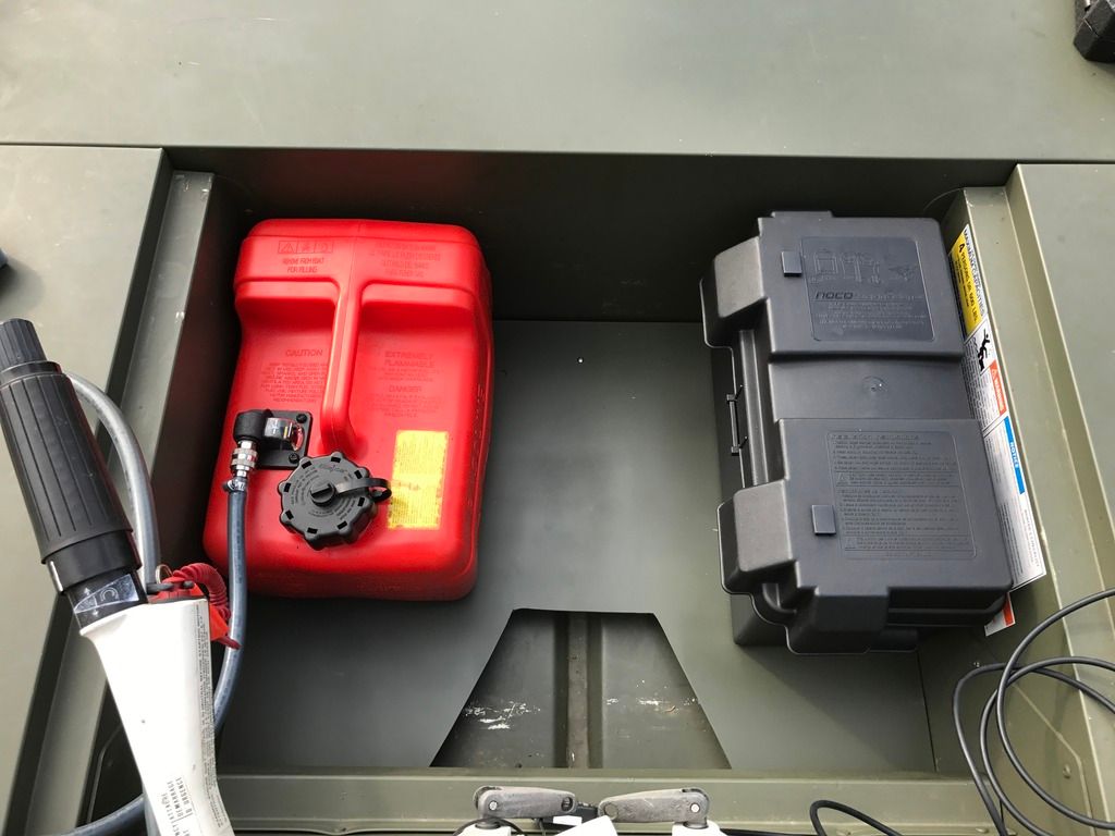

Here it is with the remaining fasteners in and my 3 gallon fuel tank and battery box dropped in. I have since fastened the battery box down. I am happy with the results...I still have room for a bus bar, aerator, bilge, a 6 gallon tank if needed, and a dry storage box for things like tools/emercengy supplies/etc. I have a hatch for this area I got from Fish On Fabrications which is already primed and painted and ready to be installed and which will be my next task.
