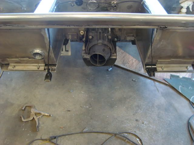

This is my current exhaust setup. You can see the old discharge above the pump and it was very loud there. With the new version on the pod the exhaust is pretty quiet until I'm running hard because the port is under water. I am running the stock water muffler as well. You can get an idea from my goofing off videos of how it sounds.
As said above, a lot of my noise is from the decking vibrating at speed. I put some fuzzy velcro at the hatch openings to quiet them down. Eventually I'll install the carpet (it's only been sitting in the rafters for six years waiting) and hope it quiets everything down.

Thanks Ranchero for the picture. Good idea on the underwater exhaust. I have an idea on how I can try that out without cutting a hole (running a radiator hose down the outside of the transom). If it pans out, then I will make it permanent.

Well, I got some flexible exhaust pipe & was able to route the exhaust over the transom & down underwater. $10 total cost so far. It sticks down about an inch below hull. Made quite a difference in noise level, but you guys are right, the exh is only half the noise source. Now I can hear all the rattles, etc. The flex pipe is temporary, hopefully will come up with more elegant design next winter.
I was concerned I would get a hydrolock situation upon shutdown/restart but that didn't happen.
The only negative consequence is spray up onto the transom. Next I am going to make a shoe to hold the spray down. I'll take a picture once I get that done.

I installed underwater exhaust & lined the engine compartment with carpet & foam. In fact have covered the top of the engine with a foam pad (I have good air scuppers, so engine is staying cool). The engine hood fits pretty well, lays on the deck carpet.
I have a sound meter & with all this I'm still at 97 dBA wot.
The good news - only 80db at idle.
My bad, didn't take readings on the original configuration, but it was louder for sure.
Looks like earplugs are going to be the plan going forward.
