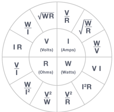

Those amp ratings seem really high unless the LEDs are very bright and/or extremely numerous.
BTW, here is a useful Ohm's Law table for calculating various properties, if two of the three relevant properties are known (using many different combinations of units).

Ya I double checked I think the 5m led strips are actually 2.5 amps. The light bar is 72 watts and the fog lights are 72 Watts combined, so 12 amps total.
I was looking at 6 gauge wire (what I calculated I need to run the 12 amps for the lights the length of the boat to the switch and then up to the lights). Seems quite large to me.
