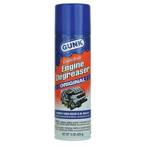

2-3x per year, but not every time you run it on muffs. this is how i do it:
step 1: engine degreaser (auto parts store)
step 2: soak (read the can)
step 3: gentle washdown with a hose, don't spray, don't mist, gentle flow of water from top down, let gravity work, & avoid watering the carbs & the electrical components like the starter, the coils, & the computer (if it has 1), cover them if you can but don't worry if you can't, step 4 saves you here, you MUST let the engine dry completely before you crank it
step 4: dry (air dry, use a towel where you can)
step 5: tire shine (this protects & makes it look factory fresh, WD40 also works, but tireshine lasts longer)
I suggest doing this as infrequently as you can get away with. While you are removing some salt, you are also washing some salt into other areas you can't see/reach

That'll work, any brand will work, I prefer aerosol for both the degreaser & the shine, these are the ones I usually get:
as mentioned, soap & water works too. the best protectant is called Fluid Film, but it ain't cheap. yes washing with water will eventually remove the coating of fluid film (or corrosion X, or WD 40, or whatever), but it takes a bit before that happens. i spray my trailer leaf springs & hardware with WD-40 whenever they look "dry" like when they stop beading water, buddy does this to his trailer, & it's from 1970 & looks brand new still. you can get WD40 at harbor freight by the gallon & pour it into a regular spray bottle like would be used for windex/409, the aerosol version gets expensive for spraying down a trailer lol
& none of this is required maintenance. the motor will run fine w/o any of this. i like to keep it looking showroom new though as well :mrgreen:
