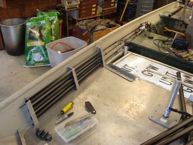

Golf club bag tubes...
The rest of the story is in my build thread page 18 I think.

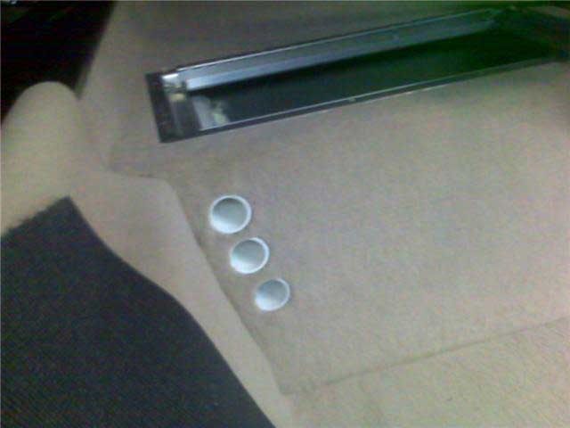

I don't know how larger your front deck area is, but I drilled holes and used 1.5 inch PVC pipes that are foamed in place and used one rod saver on each side for the reel end of the rod/reel combo.
Its a huge space saver and works perfectly in my 1660.
Heres when I was building the boat.
And here they are all done with rods in em!

Kory's design is very good looking! I might consider something like that, also.
