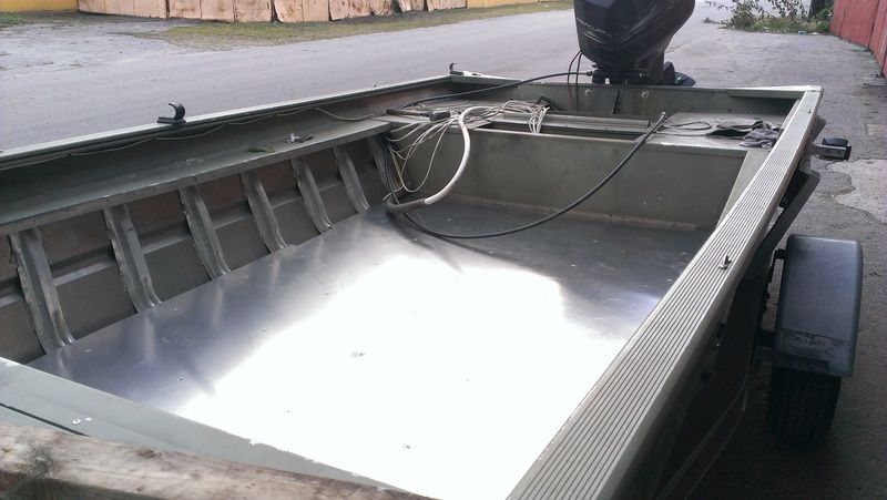

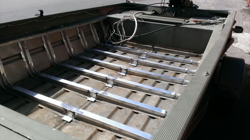

Removed the old floor and supports and welded in new ones
New 1/4" floor all secured. Is it heavy...yes! But it sure as heck doesn't pop and rattle anymore!! This made the boat so much more solid feeling that I wish I had done it originally.

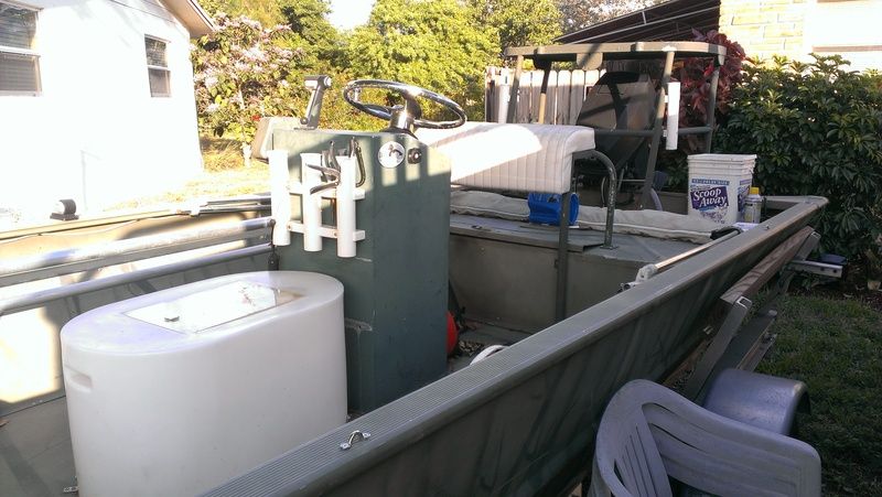

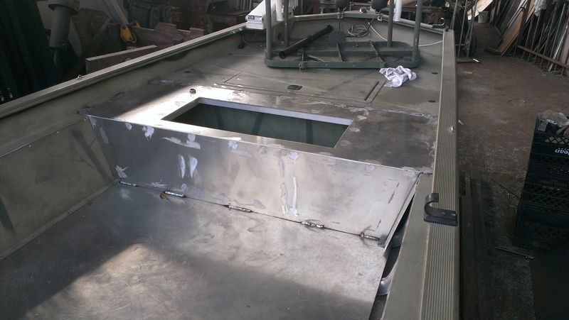

I wanted more deck space, and needed more storage so the front casting deck was extended

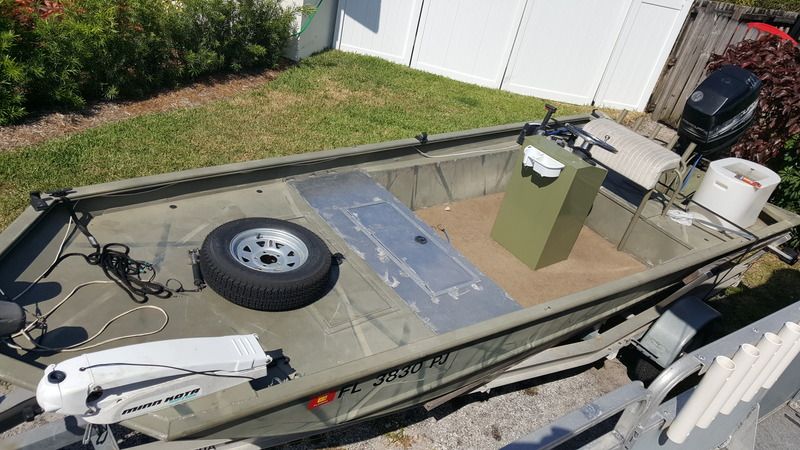

I built a new console and added a few rod holders to the leaning post which I built for the old boat. This is how she sits currently. I carpeted the floor only because i had to put something down until I can make up my mind on what I want to do with the casting decks. It's like standing in a frying pan once the sun comes up on this thing. I'd really like to have the interior Linex'd but I think it'll be way too expensive. I just haven't had a chance to take it by Linex for a quote.

I MIG'd the deck extension, floor supports, and anything that doesnt need to look fancy. I TIG'd the console, but smoothed all the corners before it went to powdercoat so it wasn't really necessary.
