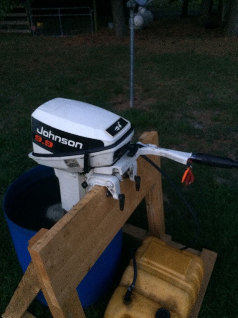

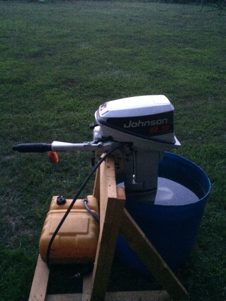

Time for a motor update. I got the 9.9 hp converted to a short shaft and put it on the boat. On the water it ran about 15 mph at 4900 rpms with me and my dad and a light load. With just me it ran 5400 rpms and did 17mph. This was with a decent shape factory 9.25x10 3 blade prop. It's not a pretty motor but it runs well.
Later I put the 15hp carb on it and lake tested it and only gained 1 mph and a couple hundred rpms. This motor needs the exhaust tube and reed shims to make it a true 15hp plus I think the main jet is slightly oversized being a size 56 but needing a 54 according to the service manual. Not sure how much all of that would help but it needs to hit 6000 rpms to generate the rated 15hp from the power curve.
I also picked up yet another new motor last night lol. It is a 1992 Johnson 9.9 hp, but with a 15 hp carb. From my understanding, these later models used the tuned exhaust and reed shims on both 9.9 and 15 models, I would imagine for cost savings during assembly. It was what I thought to be a really good deal... was super clean, had even 110 psi compression, and ran well on muffs. Another huge factor to me was the cable throttle system on these models. The gear driven one on my 82 models is as terrible as I have read. Hopefully this can be a motor I keep for the long haul and can sell off a couple of the others to offset the price.
