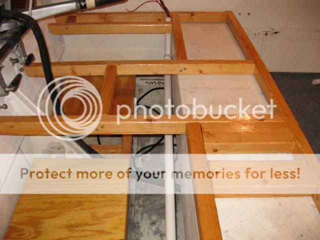

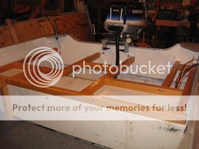

Sorry these took so long, I've been a little busy.
I haven't decided how to connect the ends of the 2x2 to the transom. I will either mount another 2x2 to the transom or bend some 90 degree strong ties to the proper angle.

No need to be sorry....Thank you so much for posting all this....This will be helping me out greatly on my build...Did you buy your 2x2's or did you cut 2x4's down to size? I was at Home Depot and did not see any 2x2's...
For your back deck you could run a some 2x2's down to the floor...or your ideas would work too..
Thanks Again!!

I ripped 2x4 on the table saw.

I hate the table saw.. :x
I did find 2x2's at lowes...and 2x3's at Home Depot...
What did you use for adhesive on the carpet?
Do you have any pictures of the framing under the back floor? Looks like you fit the plywood on top of the groove in the boat...
Are you planning on putting a floor in the front also?
Thanks Again!

As for the floor, I don't have any pictures. When I got it carpeted I dropped it in to check the fit, it fit a little to good. I think it will have to be cut out when the time comes.
I did this picture in paint. The inner supports are 2x4s on end, the outer ones are 2x2s. I put a short 2x4 in the middle to keep the others from turning in. The 2x4s and 2x2 sit on top of the ribs and are screwed in place through the plywood. All of the plywood is 5/8". The floor sits in side of the groves and is real solid. I will be adding the front floor.
